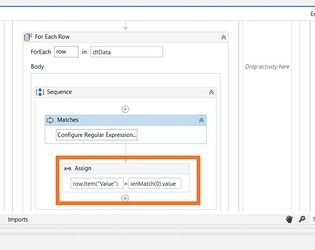

You can’t add code to the Regex (String) column. Everything you enter there will be treated as string instead of code.
I would suggest that you add an extra column called Group. Then you can check in the for each loop if row(“Group”) is empty or not. If empty, assign row.Item(“Value”) the full matched value. If not, assign the matched group value instead.
but instead in another example that I have if it works assigning the regex expression as a string … what datatable format do I assign to the regex field?
Regular expressions are just strings so it’s fine to add them to the Regex column.
(?<=EUR)\n\n(.?(?=\s))\s(.?(?=\s))\s(.?(?=\s))\s(.?(?=\s))\s(.*?(?=\s))
But varInf(0).Groups(3).ToString is code, and that is the part you can’t put in the datatable.
Okay, so I add the entire expression to the regex cell, and then what do I call that specific group of data?
In the for each loop:
You will need an If activity to check when to assign the full match and when to assign the group match (hence the need of a Group column in the datatable).
but even though I call the group manually, I never get to show it or isolate it
Did you check the group in your match?
ienMatch(0).Groups(3).ToString()
Here’s an example: RegexGroupTest.xaml (11.2 KB)
The column Group has been added with Int32 as type and default value 0. Groups(0) returns the full match, so let it be 0 unless you want a specific group.
