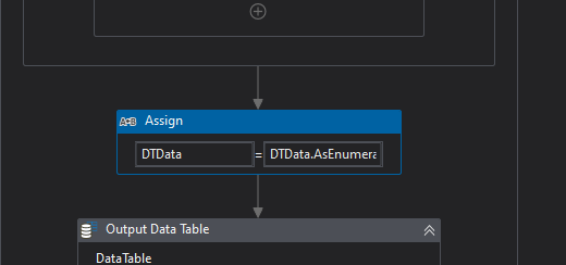

sure - currently this is what i have
so i what i would like is a variable which i can set to
DTData.AsEnumerable.Where(Function(x) CDate(x(“NewDate”).ToString).Date >= (new DateTime(2022,9,01)).Date andAlso CDate(x(“NewDate”).ToString).Date <= (new DateTime(2022,9,20)).Date).CopyToDatatable
i will be running the same linq query for different environments, so rather than changing the query 3 times i would like to change it just once
thanks
