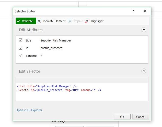

Hi @JacelynLok08 ,
If you have used “Get Text” activity then open it in Ui Explorer and select aaname and change aaname value to “" . If you didn’t change you will get error
aaname="
”. Like this your get text variable will have the value of aaname.
Now print your get text variable in message box or write line. See what you are getting.
Then you can proceed with steps i’ve given earlier.
Hi Manjula,
I have amended the aaname = ‘’’
But it shown there is error on selector as shown on below.
Does I use wrong symbol or anything that I have did it wrongly in the Ui explorer?
Thanks.
Jacelyn Lok
aaname = “*”
" is a wildcard. Any value can accept here so you will always replace dynamic values with "

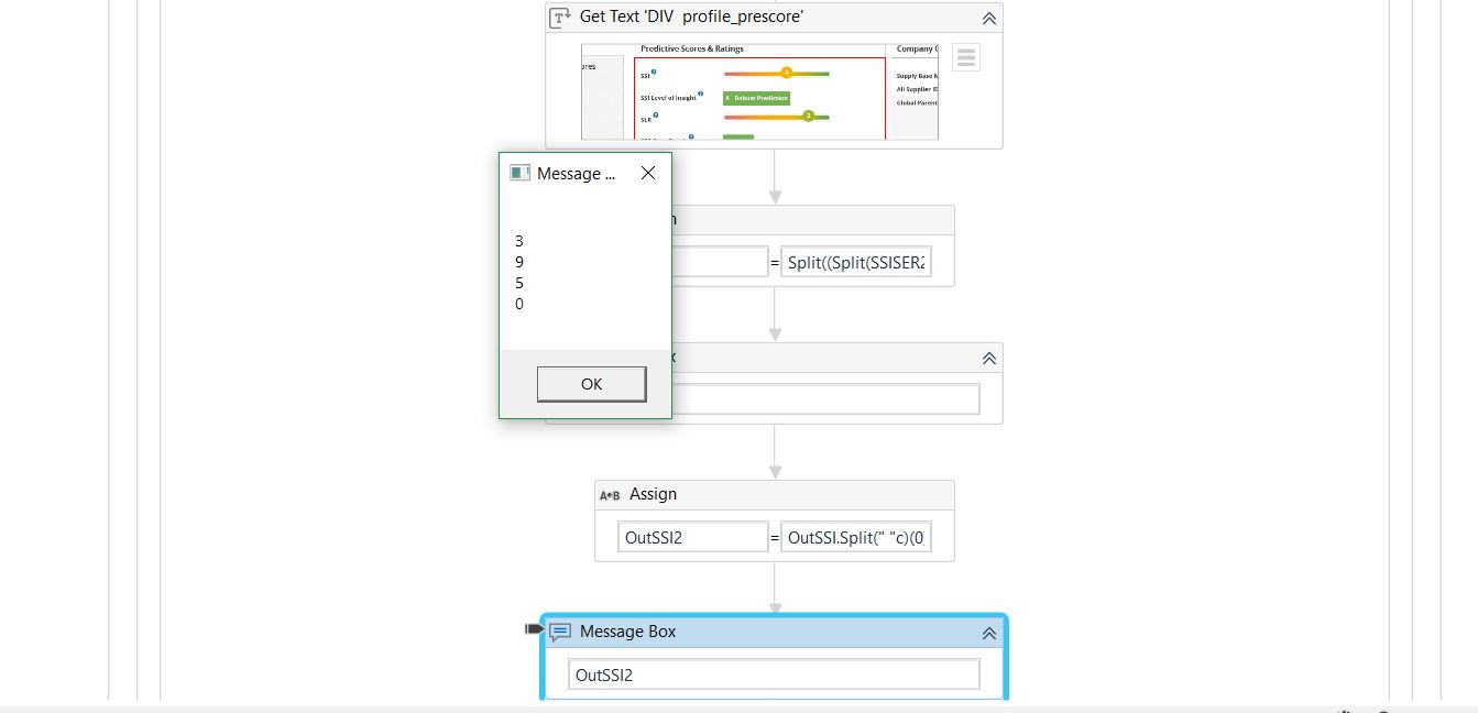

Hi Manjula,
Thanks for the advise. I have follow exactly what you have guide me. But the outcome still the same with 4 numbers arrange vertically.
Thanks.
Try split by new line then.
can you tell what you are getting in strReq and getRating
Hi Manjula,
The outcome for both are the same as below in the message box.
10
9
5
0
Thanks.
Change the split like below
getRating = strReq.Split(Environment.NewLine.TocharArray)(0)
