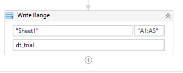

Hi Everyone,
I’ve been using the Write Range for formula input but doesn’t seem to write in the range that I have input.
Any help will be much appreciated.

Hi Abisha,
Thank you for your response.
Yes I’m writing a formula in multiple cells. I have also tried Write Cell method but doesn’t input the correct formula that I have declared because my formula has many “” that’s why uipath declares short string

Try this in the write range
“=IF(C2=”“”“,”“”“,VLOOKUP(C2,Grade!$A$1:$B$5,2,TRUE))”
Wow thanks! It worked!!!
