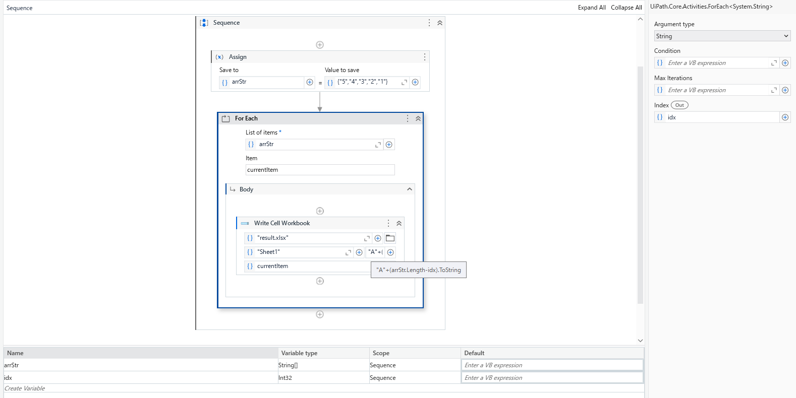

Can you try to set idx at Index property of ForEach activity, if you have not yet?
@Yoichi
Thank you for your response!
It seems to be working well.
Could you please guide me on how to adapt the code if the starting cell value is A32?
Thank you!
If starting address is always A32, the following will work.
"A"+(32-idx).ToString

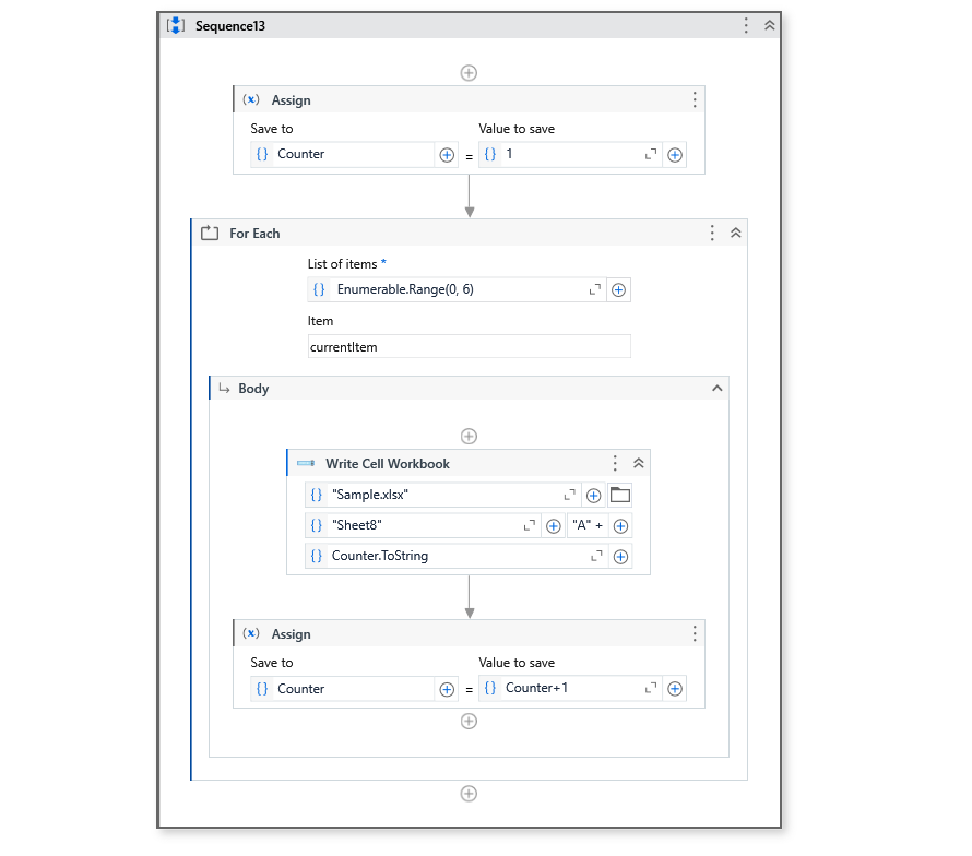

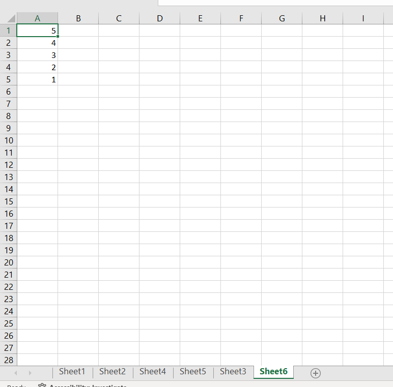

Hi @22222222asas
If you start writing from the cell A32 then follow below process:
Counter is of DataType System.Int32. In the cell value give "A" + (33 - counter).ToString()
Output:
If you want to start writing from A6 then you can do the below way:
Counter is of DataType System.Int32. In the cell value give "A" + (7 - counter).ToString()
Output:
