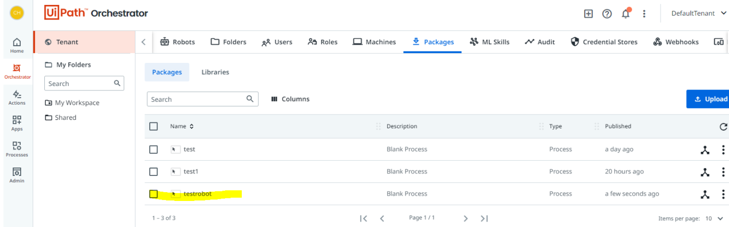

  1. on orchestrator can see the packages

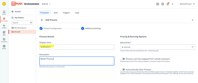

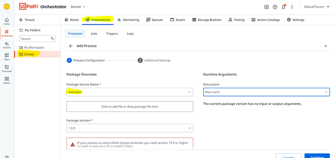

  1. Add process
  2. Go to Automation > Add process
  3. Continue
  4. Start the process

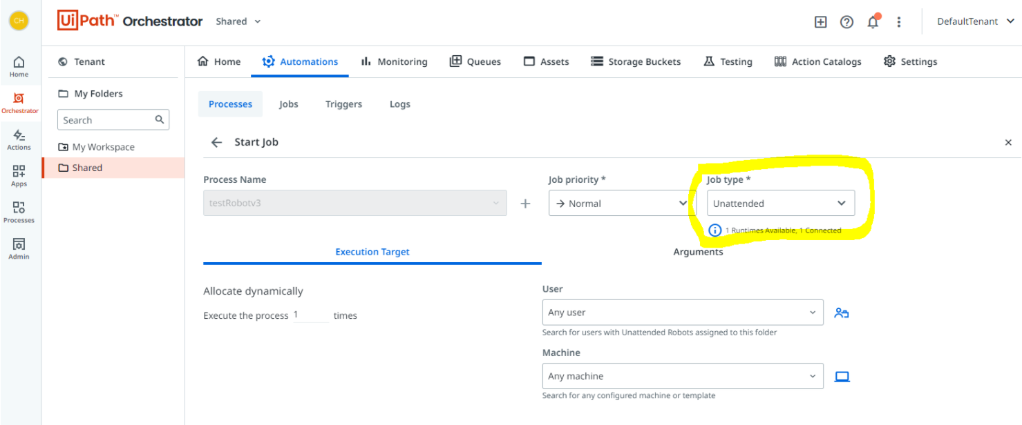

  1. select unattended
  2. Command sent to robot
  3. After that trigger the process
  4. the robot is running
  1. UiPath assistance show robot ran but i did not see any window message pop out…
