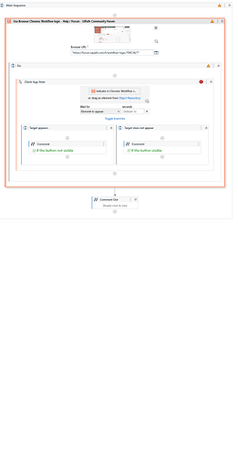

Use the check app state or else the elements exists activity.
After using that activity indicate the buttons and if the buttons were not highlighted then you can proceed with the further steps in the then block. If the buttons were highlighted then you can do the necessary actions in the else block.
You can also use Get Attribute Activity to get an aastate attribute if it is disabled then it’s value will be unavailable, focusable and if it is enabled then it’s value will be focusable.
according to this activity output you can proceed further

Hi @Iswarya_P1
