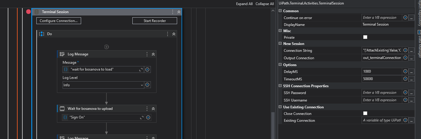

I have this WF I finish it and the AS400 closed instead continue to the next WF, Can someone explain what I am doing wrong please ?

The AS400 just close

It does the login and when the login is finished it simply closes the As400 window
I don’t open, it opens automatically with the setting

as per logs looks like you are inside the code already…can you show which activity it is on
is the close ending?

I figured out the problem
In the application usage part the value in the close parameter was empty
I put never there and it worked
Again thank you very much for trying to help me as always
when Use Application/Browser was referred, we would suggest to check also this usage:
  • Terminal Session Activity (1)
    output. Connection Variable - myCN, Close Connection - False
  • Terminal Session Activity (2,3,4…)
    using myCN, Close Connection - False
  • Terminal Session Activity (Last)
    using myCN, Close Connection - True
