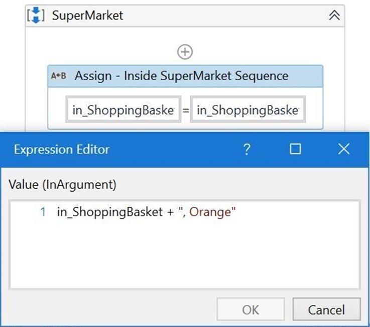

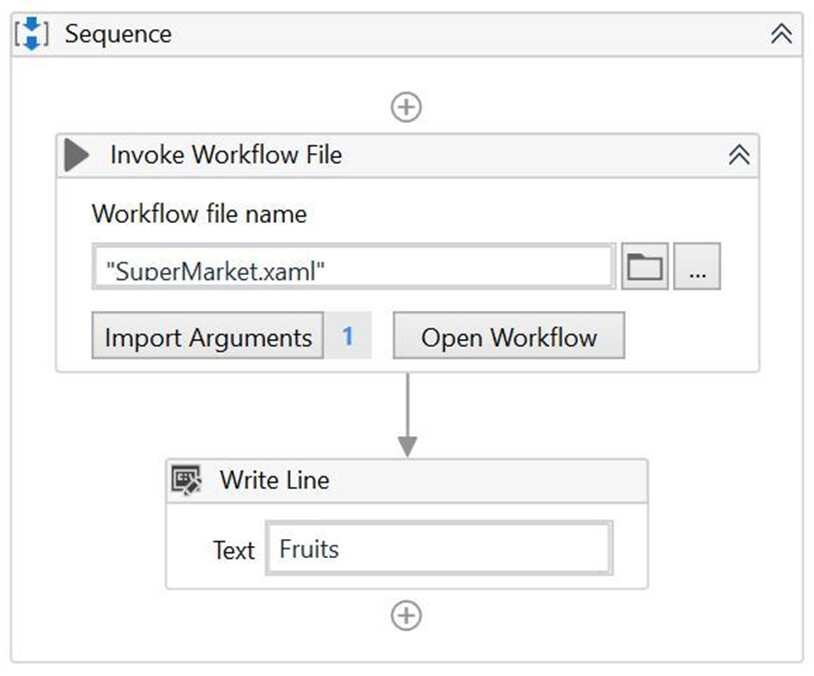

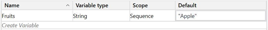

Why is the result of the Write Line 'Apple' and not 'Apple, Orange'?
@ivette_lugo
Thats because the direction is in …it ahpuld be in/out…
Because it is only in the argument is modified inaide but the modified value is not passed out to the fruits string
Hope this is clear
Hello,
Please change the direction of the in_ShoppingBasket Argument to IN/OUT so that the updated value will reach out to the sequence (to the variable ‘fruits’) where the write line is used.
