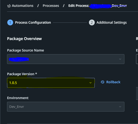

Hi @karol.pang ,
Once you publish new package you have to update process version in orchestrator.
Have you done this…?
If not, navigate to process tab and select respective process. There you will get list of versions along with option to select package version. Update version to latest / required version and update process

If you are using community version, select Automations/Process /<process_name>and click on edit button.
Then select the package version from below highlighted dropdown
