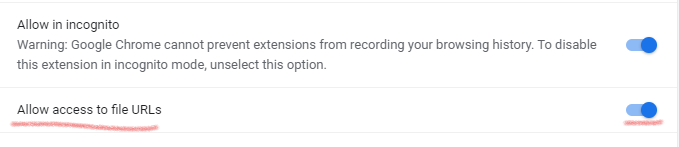

Have you enabled the Incognito Mode and FileUrl options in the plugin on your VM?

I can try enabling Incognito Mode but Can you please Explain what FileUrl mean?

Hello,
Here is the setting for the Chrome Plugin
