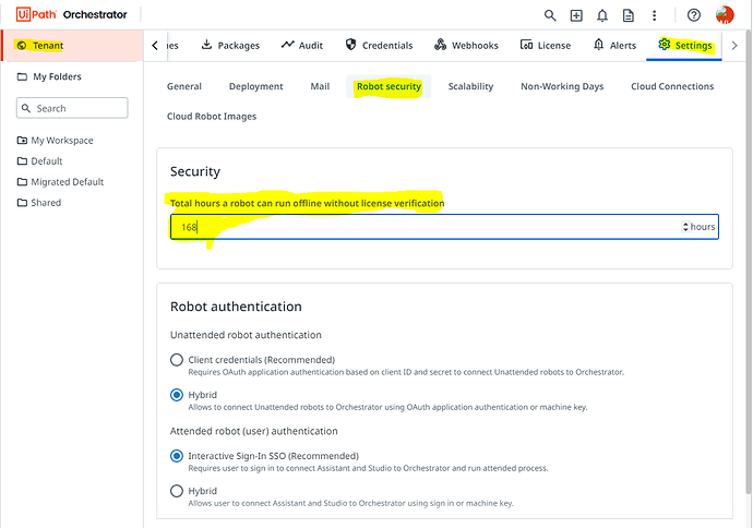

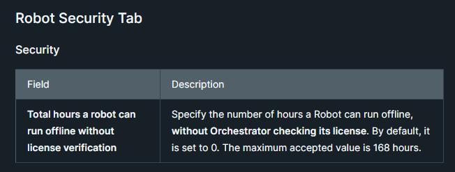

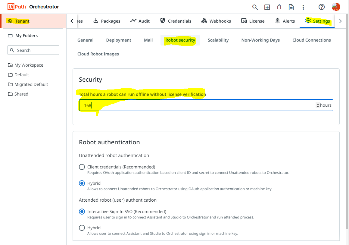

Orchestrator is down, can the robot be used?
Yes, at maximum of 168 hours
