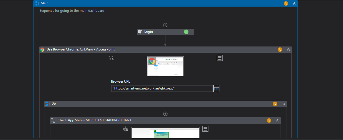

Hello Team,
I created a login library but when I install it in my workflow I get some issues.
The bot logins and then logs out when it reaches the main workflow, so the rest of my activities can’t be executed thus the breakpoint of sequence.
Kindly advise, thinking the problem could be with the use browser activity URL since the URL is not exactly the same as the one in the Login activity(Library).

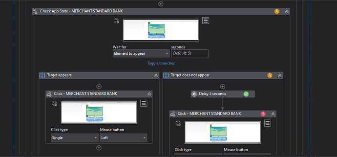

I went ahead and I ran the workflow in debug mode with the Execution Trail enabled.
But as I had highlighted earlier the issue comes in use browser activity as you can see in the screenshots below.
So according to the execution trail you can see the bot is able to login.
And here the bot fails to locate the UI element because the element appears after login and at that point the bot has already logged out.
To shade more light the use browser activity opens up a new browser window, so there is no continuity in the workflow.
Hope this is a bit more clear @sonaliaggarwal47.
