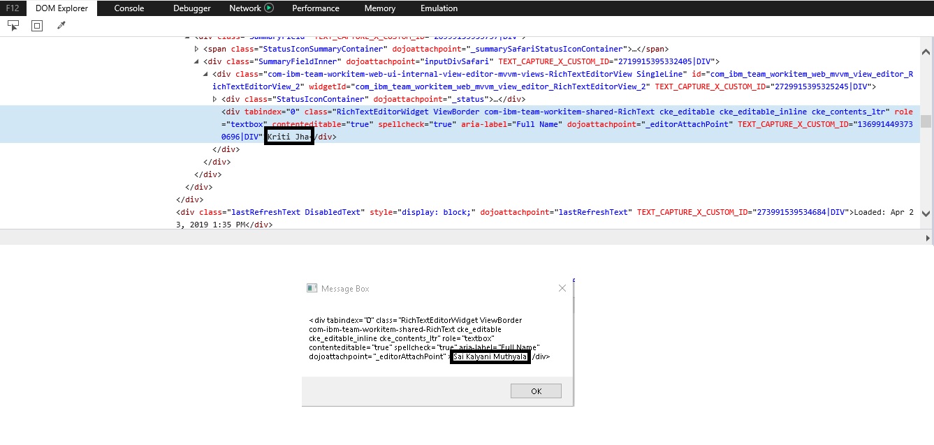

On top you can see what’s currently in the field and at the bottom what I’m getting from uipath, which is the previous record. I can’t provide more as there are personal details.

The first one is not a selector, is what DOM explorer is showing and '‘Kriti Jha’ is correct, the second one is the selector and ‘Sai Kalyani Muthyala’ is retrieved, which is wrong.
It seems that uipath is not getting the correct data until the browser is refreshed, so if I put a refresh before reading works fine. So any idea how to get current data without refreshing the browser? :smiley:
