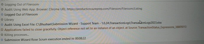

I publish my library all variables are properly passed in the library. It gives an error
“Application has been forecfully closed”. Object is not to reference". So it doesn’t perform library activities.
This issue is disrupting the flow.

@BHUSHAN_NAGAONKAR1
As per error some variable you are using is not being passed or is pssed as empty
And as per source I guess you can find which variable it is
