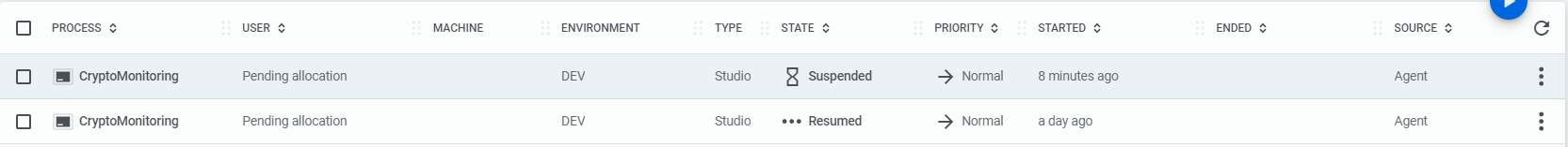

I have an orchestrator process project, to test out long running workflows. I’ve published to orchestrator and I’ve successfully sent the form task to the task queue, open the task form, assign it to myself, and see the form as i’ve designed it. When it’s sent to the task queue, it’s state is displayed as suspended, which is fine. However, when i go into the task and complete the task object, it moves to a user of “Pending Allocation” and a state of “…Resumed”.
I can’t figure out how to allocate a user to it. I’ve launched the process as an attended bot, i haven’t tried using the unattended yet. I would think if i wasn’t to be launching via attended bot, it wouldn’t let me serve it up on my desktop. In short, how do i trigger the bot to start up after the wait for form task has completed?

This is what my job queue looks like, the top row reflects a task that i’ve triggered from my desktop to the task queue, before any assignment or completion is done. The second row represents the state of the job after i complete the task:

Solved
Needed to launch the process using an unattended bot. Just needed to think through it a little longer. Stumble on!
