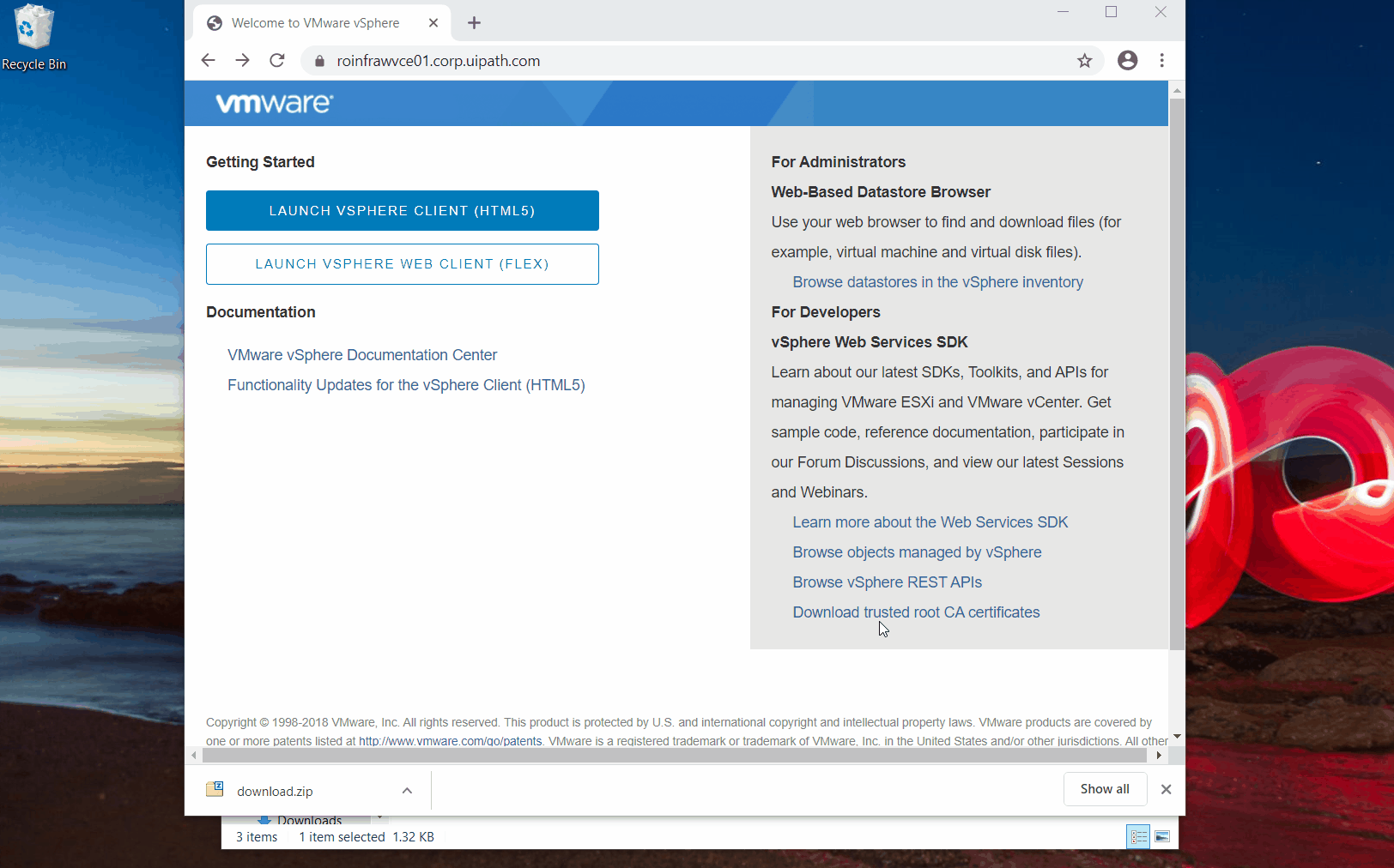

Root Cause: This is because the trusted root CA certificates from vSphere is not installed on the machine where the Robot is running.
Resolution: Install the trusted root CA certificates from vSphere on the machine where the Robot is running, as shown below,
