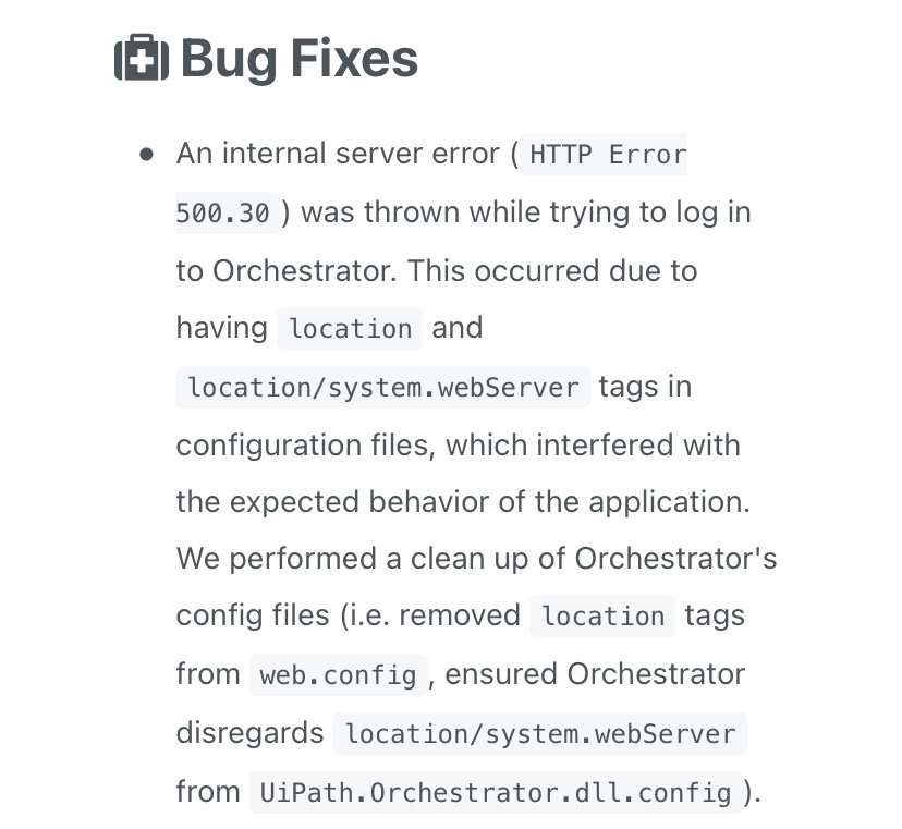

Please check this.Also please check the event viewer on the server if there is something unusual
Orchestrator - 2020.10.2(%20HTTP,expected%20behavior%20of%20the%20application.
Hope this might help(agrred that you are able to login…but still worth a check)
