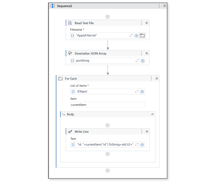

Hi @frederic-f.bonnet
Workflow:
xaml:
Sequence2.xaml (8.7 KB)
Output:
Regards
Check the below workflow file:
BlankProcess25.zip (697.5 KB)
Regards

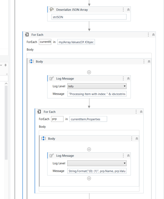

Looping over items and properties
Sample logs
grafik
DataType specific extraction Demo:
grafik
Also have a look at this:
grafik
