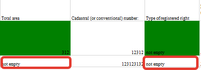

Thanks, I did something like that. But there is still a question. The updated cells should turn green, but in the sample 5 file, the second line is updated, but not green. What could be the problem? Thank you.

Oh, sorry, third line. I also had to color the cells in the third line (since the value in the “Cadastral (or conventional) number:” column matched). What is wrong?

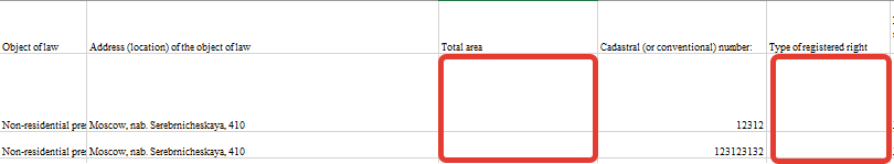

    Before:

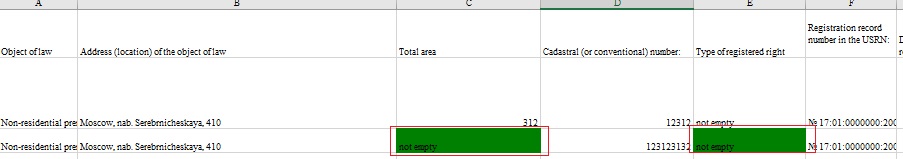

    After:

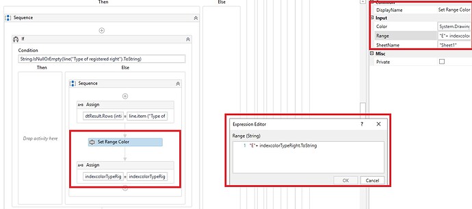

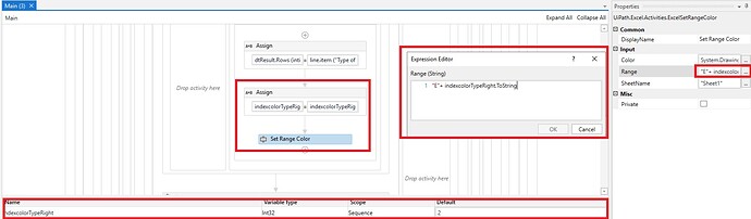

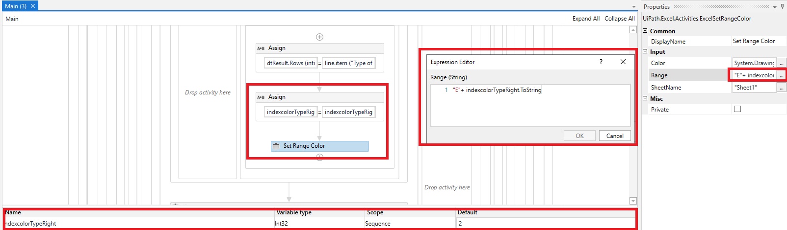

The set range color activity turns the updated columns green.
Okay @sereganator, Got it.

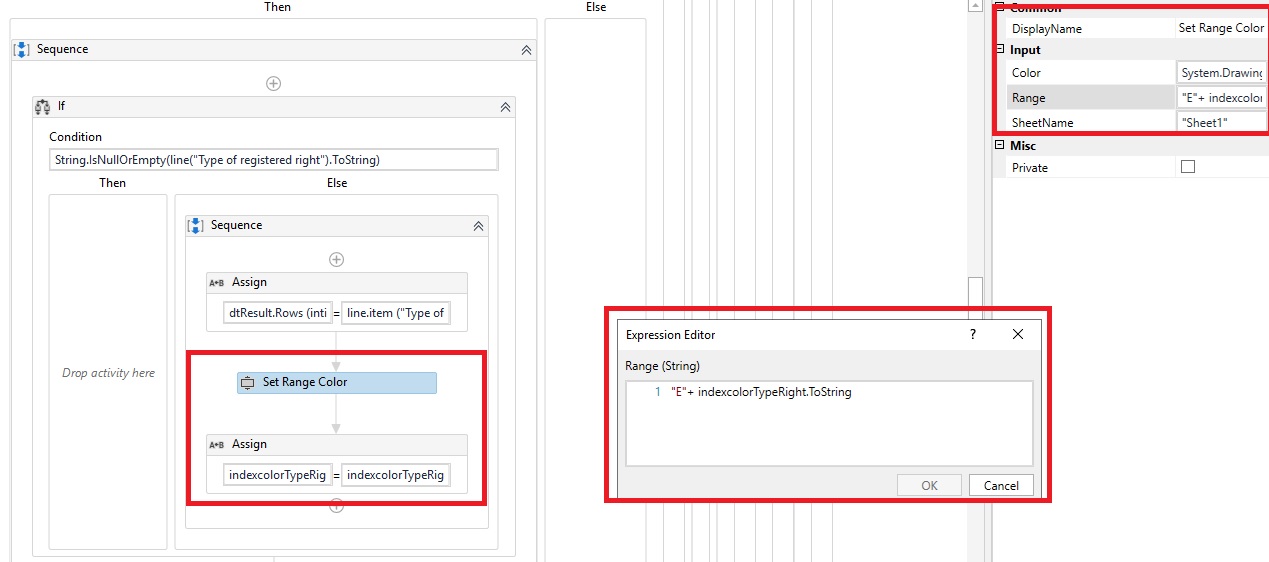

So as I can see above, indexColorTypeRight is getting calculated in assign after set range colour. If I’m not wrong.
Could you please have that before set range color.
Thanks :slight_smile:
I did it, now it paints only the third line, the second does not.
I changed the counter value by default (set 2 or 1), it does not help. What is the problem? Thanks.
What is the expression on the right side of the assign ?
index should be row index + 2
Why index should be row index + 2? You need to paint over each updated line, not across the line.
colour
You are in the for-each row right, so your indexColorTypeRight should hold the row index value you are processing.

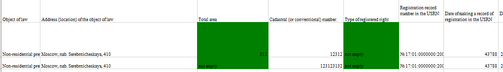

Does it work for you? Because I also color the cells incorrectly.
