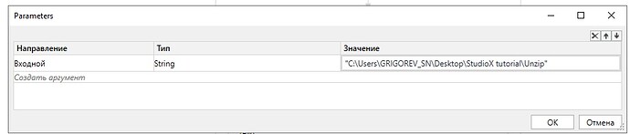

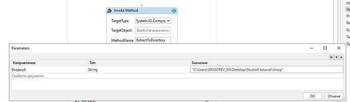

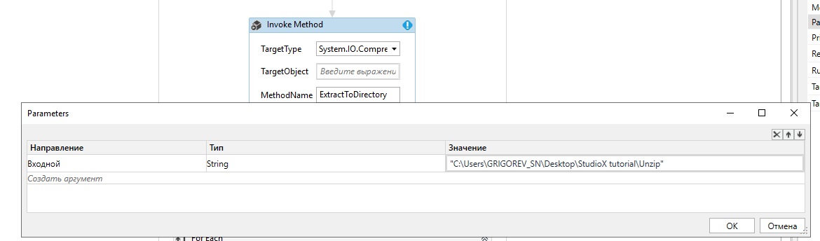

  1. So? (see screenshot)
  2. We get file names through a for each loop? How do I get just the filename? Truncate the file path (replace method) and leave only the name?
1/ No. ExtractToDirectory method require at least two parameters. See the documentation above.
2/ Path class implements many methods for folder/file name manipulation.

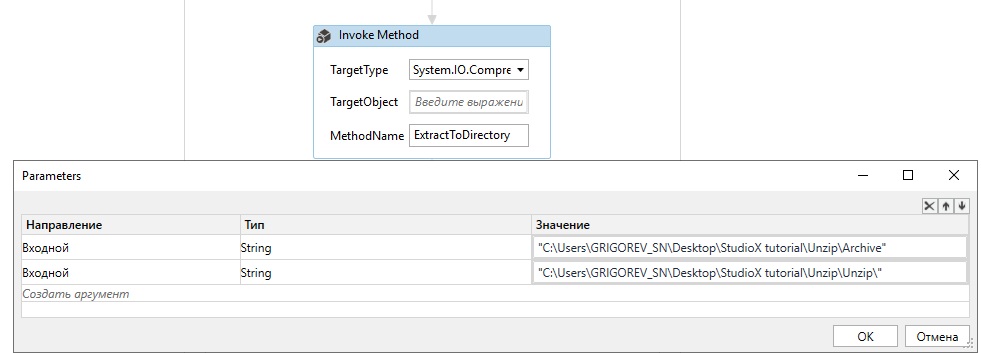

  1. sourceArchiveFileName and destinationDirectoryName?
Sure
The first parameter is where we get the files in the archive from, the second parameter is where we create the folder, right? Thanks.
Now to the second parameter you need to add an expression to extract the file name?
1/ Pls read the documentation CAREFULLY.
The path to the archive that is to be extracted.
The path to the directory in which to place the extracted files
