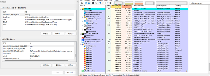

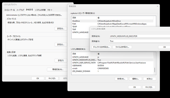

I granted administrative privileges following the article below (editing system environment variables and restarting the Robot service), but it is not functioning correctly.
The password is supposed to be entered in the image, but that part is not working.

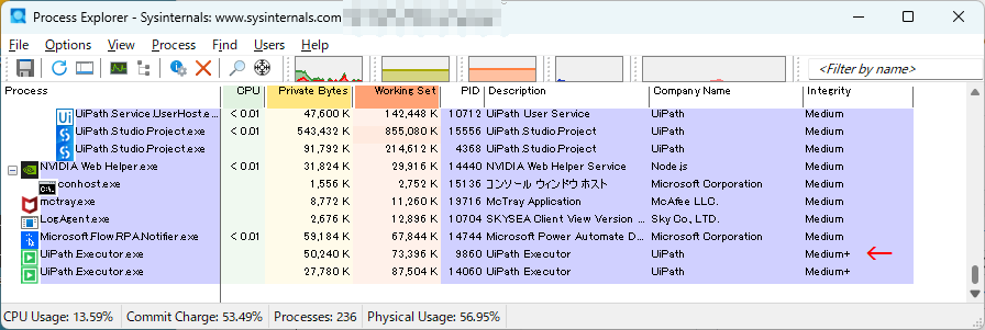

It seems that the version requirements are met, so the next step should be to check whether the relevant process is running at medium+ (using tools like Process Explorer).

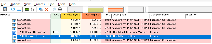

UiPath Service Host.exe was not functioning on medium+.
The execution is handled by UiPath.Executor.exe, so please check this.
Thank you for your feedback.
It was running on medium.
It was not on medium+.
I don’t think the settings are incorrect, what do you think?
Have you restarted after changing the environment variable settings?
Yes, I am rebooting according to the article’s instructions.
After updating Windows to version 25H2, the “Please enter your credentials” screen no longer appears. The issue may have been resolved.

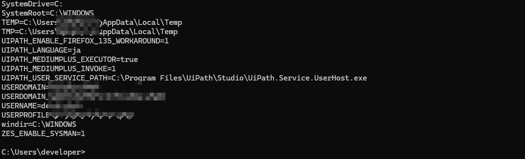

Studio 25.10.13 + Windows 11 Pro 25H2
Command Line output of set
