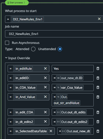

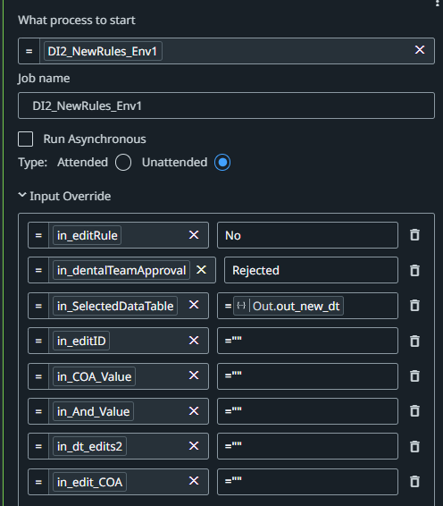

I have one app and one process that feeds the app with a datatable called “out_new_dt”. I have binded that datatable to a custom list and will make edits to that binding. And then push it back into the process to a variable called “in_selectedDatatable” to create queue items.
My issue is that I have two places where I run this process: one for editing the details and one for accepting the details. I have two buttons with the below configurations
Accepting
Editing
When I click the edit button, the process starts are runs as expected. When I click on the Accepting button (with very similar configuration) I get this error
Unable to start orchestrator process - invalid response received from orchestrator
I have tried several things. Specifically - When I remove the process argument “out_new_dt” the process will start. I’ve been banging my head trying to figure this out. Could it be because the edit anda accept buttons are on two different pages (each with bindings to out_new_dt)? No idea whats happening. Thanks!

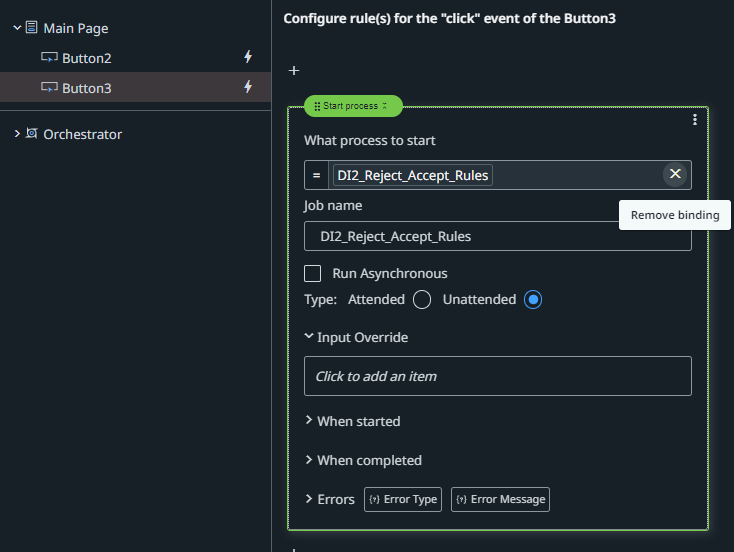

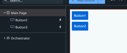

@Arvind_Kumar1 or @evan.cohen please help :slight_smile: - This is still a big issue for me. Here’s another example of how messed up this is. I created a super simple test. I have one app with two buttons Button1 and Button2
snip1
These two buttons have the same exact action (running a process)
When I click on Button1, the process starts without issue. But then when I click on Button2 (or Button1) that runs the same process I get this error “Unable to start orchestrator process - invalid response received from orchestrator:”
There is no error log of this issue for me to dig deeper into, and this issue only started cropping up a week or two ago. What is going on??
