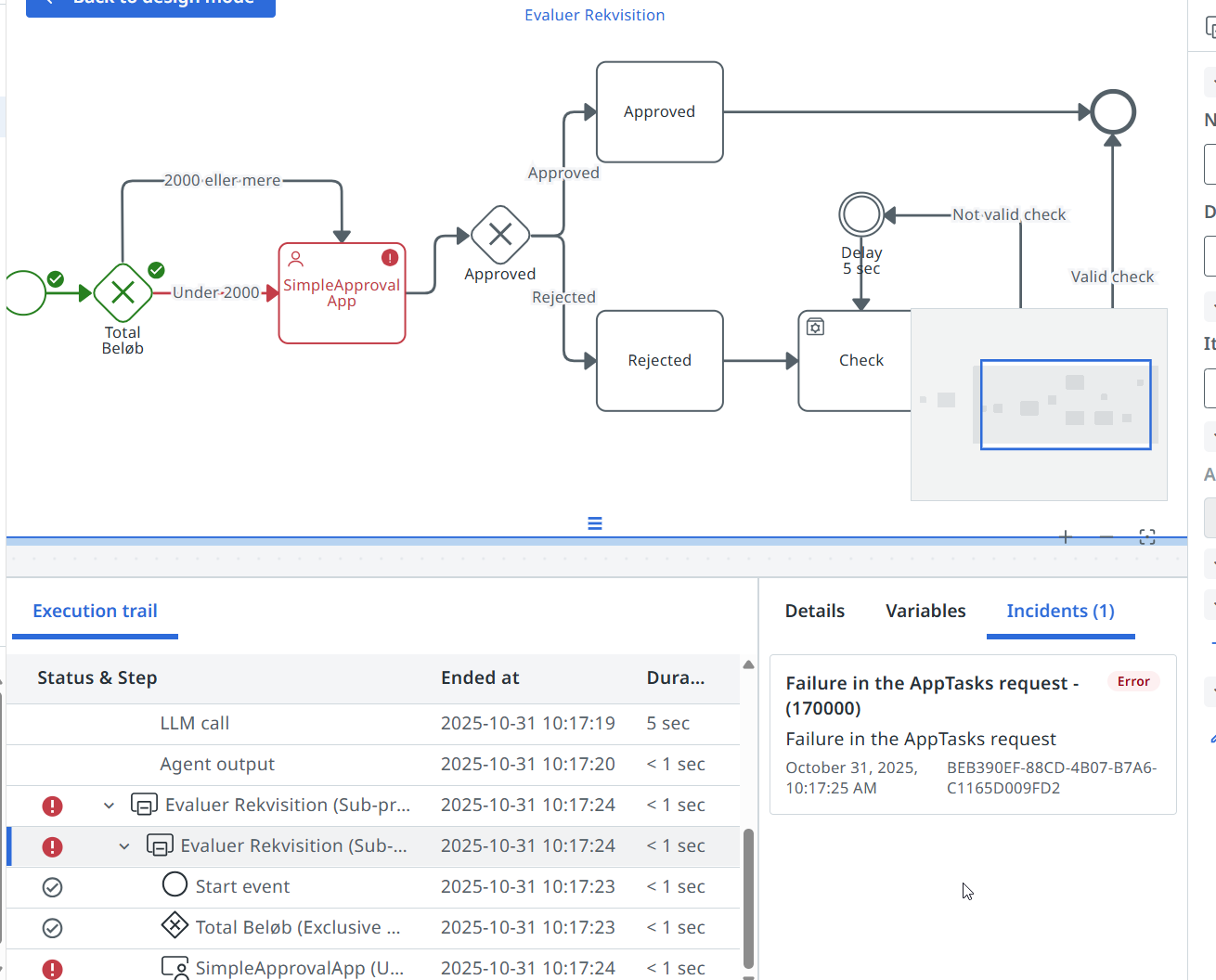

I’m working on a UiPath Maestro process where I need to pass email data into a UiPath App.
Here’s what I’ve done so far:
  1. Created an Agent to read emails.
  2. Built an RPA Workflow to extract data from the emails — such as Customer Name, Customer ID, Order Number, etc.
  3. I’m trying to send this extracted data to a UiPath App using AppTasks within Maestro.
However, when I try to run or publish the app, it’s not working. I’m getting the following error:
Failure in the AppTasks request (170000)
I also tried changing argument directions (In/Out) in the app, but it still shows the same issue.
I’ve attached my Maestro project screenshot and the error details for reference.
Can anyone please guide me on how to correctly pass data from the RPA process to the UiPath App in Maestro, or explain what this error means?
Thanks in advance for your help!
@Abhinav_Rai - It seems like we have a production issue on this. You can follow the status here - UiPath Status - Action App Task Creation Failing for Maestro Users in India and UK regions
Your code should start working once it is resolved.
Hi @ankit.saraf, thanks for the reply, but I’m still facing the same issue.
@Abhinav_Rai - I have asked the team to continue to investigate, maybe there is something more here.
Hi.
I have the same problem here, with more or less the same setup:
Can you share the properties panel and it’s configuration in a screenshot?
