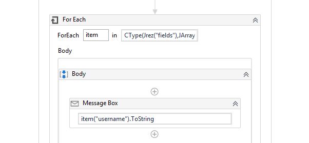

i am getting full jason after sending post command via http request.
i am able to get key from my jason but when i am trying to get username i am not able to get , it is giving error like “For Each: Object reference not set to an instance of an object.”
check the following screeenshots.

In your Case be Very careful you need to look for NAME NOT for USERNAME.
username is just a part of the link from self object check very well you Json structure put your JSON in NotePad++ exactly like me to see the correct structure.

Below jason i am getting (below is not full )
“message”: "Result is :{"expand":"names,schema","startAt":0,"maxResults":15,"total":1,"issues":[{"expand":"operations,versionedRepresentations,editmeta,changelog,renderedFields","id":"58905","self":"https://jira--8","key":"E2CLARITY-560","fields":{"customfield_10190":null,"customfield_10191":null,"customfield_10192":null,"customfield_10194":{"self":"https://jira-.com/sdesk/rest/api/2/customFieldOption/10276","value":"N","id":"10276"},"customfield_10195":{"self":"https://jira-.com/sdesk/rest/api/2/customFieldOption/10277","value":"Y","id":"10277"},"customfield_10196":{"self":"https://jira***.com/sdesk/rest/api/2/customFieldOption/10280","value":"N","id":"10280"},"customfield_10197":null,"customfield_10198":null,"customfield_10199":"2021-03-05T16:06:00.000+0100","resolution":null,"customfield_10500":"0.0","customfield_10621":null,"customfield_10501":"0.0","customfield_10622":null,"customfield_10502":"0.0","customfield_10503":"0.0","customfield_10624":{"self":"https://jira-.com/sdesk/rest/api/2/customFieldOption/11477","value":"PrePaid","id":"11477"},"lastViewed":"2021-04-08T08:15:23.447+0200","customfield_10181":null,"customfield_10183":null,"customfield_10184":null,"customfield_10185":null,"customfield_10186":null,"customfield_10187":null,"customfield_10188":null,"labels":["POD1"],"customfield_10620":null,"customfield_11700":[{"self":"https://*****i.com/sdesk/rest/api/2/user?username=GSARANGI","name":"GSARANGI","key":"gsarangi","emailAddress":"girija.sarangi@.com","avatarUrls":{"48x48":"https://www.gravatar.com/avata
how can i separate name from jason ? i tried so many times with different different values.
use this site to format full json
and the be very carreful on movie logic
