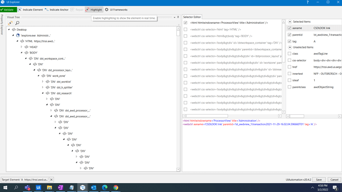

Below is the Screen-shots
  1. Edge container where you will get the access of controls only.
  2. But when you try to access the element. the Dom gets modified as IExplore.exe
  3. Application screen shot when i highlight , it is successfully gets highlighted
  4. But when i try to run I am getting an error:

That’s what i have explained Refer Screenshot 1 and 2 where i have explained.
  1. When you want to access the controls it is available on Edge moreover the list and everything is not available now when you inspect the element the it is converted into Iexplore because Edge is running in IE mode.
    I have tried below properties and it is not working and not validated:
Thus i have modified the selectors :
