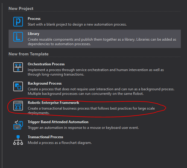

Also, Studio has a option to directly create a REFramework project without downloading. Try that option as well and see whether it allows you to edit it… let me know whether these two options work for you

This is only with REFramework. Can you let me where is the option to create the REFramework project? Thanks for your help.

@g0furtherwithAI
This is the option
