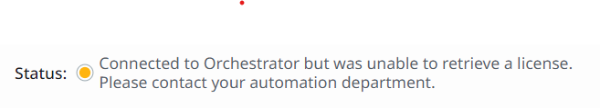

Getting the below error while connecting the Orchestrator.
Screenshot2
Also, assigned the licensed in tenant but when I try to connect with my machine and it’s showing connected,(Unlicensed).

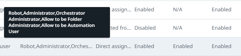

@Riddhi_Parekh
Did you create the user and assigned robot role?
cheers
yes, I assigned the robot role.

@Anil_G Getting below error while sign in UiPath assistance.
SC1
@Riddhi_Parekh
Looks like you have not given proper license to machien…or the machien detils are wrong…can you please verify
