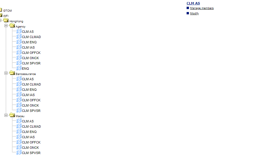

Unable to click on subfolders which are dynamicin web application
Hi I want to click on subfolders which I have uploaded for your refernce. I need to click on each blue coloured folder everytime and click on manage members on right side. once I click on manage members another page opens and again I need to get back to this folders page and extract all subfolders and click on the next folder peresent. The folders are dynamic. I used data scraping and used for each row activity in data scraping click on that folders. But everytime it is clicking on the same first folder. Selectors are like this “

Hi @rahul.reddybytinty,
If your automation is clicking everytime on same folder it usually means that your selector is not dynamic enough. Use click activity on two different elements and compare their selectors. There must be a part which will differ and which can be used for looping through each single element.
