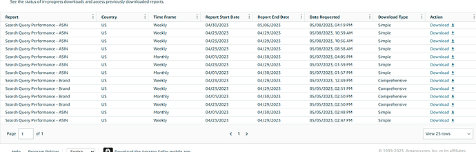

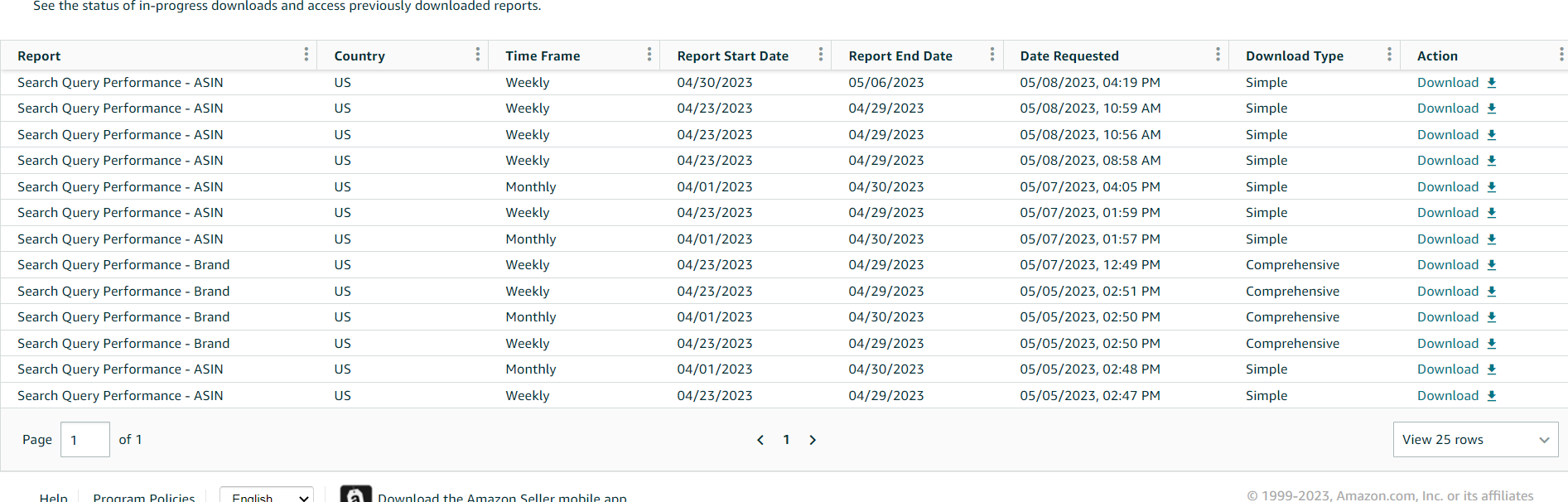

every time i want to click on the download button first assurance only,
Problem
No Fixed control id
Extract data table also does not work
If anyone is free can you join the below link and guide me

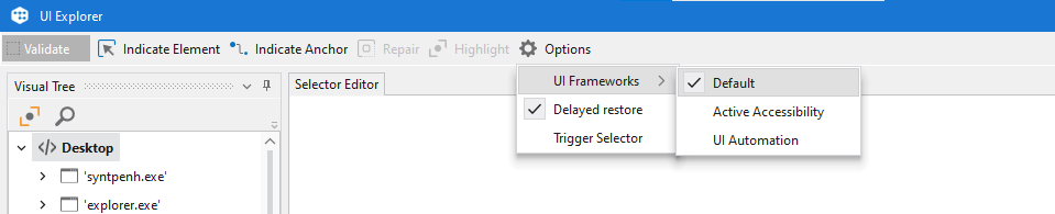

Hello @JSR_Techno_Talk_s
Did you tried using different modes of uiframeworks

@JSR_Techno_Talk_s ,
Did you try with the Find Children Activity?

Hi @JSR_Techno_Talk_s ,
If you aren’t able to directly click on the Download button using Selectors on anything,
Try extracting the table and the URL behind that column, and hit URL’s separately to download the file.
Let me know if this works.
Thanks!
