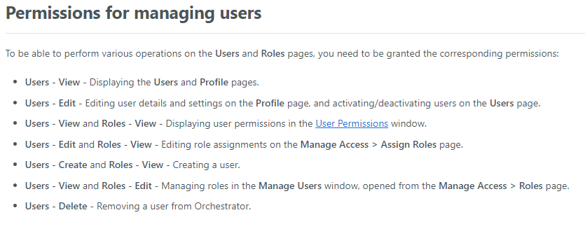

Just to be precise, I would like to know how each permissions affects the way account can access resources in Orchestrator and Studio.
Some tenant level permissions are directly connected to use of Ochestrator resources by UiPath Assistant however the only description that can be found is that you can view, edit, add and delete it without further explaination.
What I’m looking for is something similar to the last paragraph of the page you linked, but for all the permissions: Managing access and automation capabilities

It’s confusing because it’s quite self-explainatory which permission does what, but there is no detailed page which describes each of the permissions in details except for Users I suppose.
