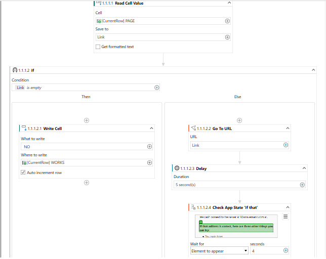

My two queries I have are: where did you get the “Link” from (how do I generate that Link) and on the other hand, in the step of using check app state “if that” where did you get the screenshot.

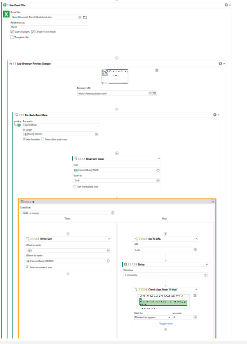

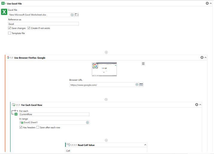

Firstly, Here “Link” is a variable which I created to store values for later use. In “Link” I was storing values of PAGE column which was provided in the excel. For Each Row of the excel file “Link” was storing the PAGE column value inside it.
After getting that link we visit that webpage. And it continues.
Secondly, when you will use check app state activity, you will see that the activity needs you to indicate an element to check its state. Here I was indicating something which comes when we try to search for a website which is not valid. You can indicate anything from those kind of sites to check the state of the web page.

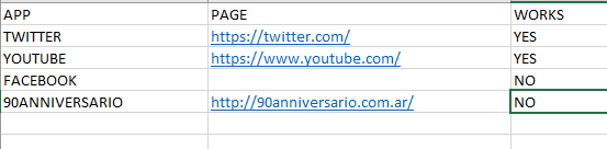

Thanks a lot! It served me a lot and it worked correctly!
Regarding indicating an element to check the status, as different errors appear I decided to use a URL check, and it worked perfectly!
My 2 new questions are now:
If when entering a page it redirects me to another, how could I make it so that in an excel column it marks “YES” in case of redirecting and “NO” in case of not redirecting (that is, how to build uipath so that you know that was redirected to another page and completed the excel with “YES”) ??
and the last one, if in case of entering a page (for example “facebook.com”) after loading its URL it changes to “https://www.facebook.com/”, that is, that "is added. https “how could I mark in an excel column with” YES "that has that https?
