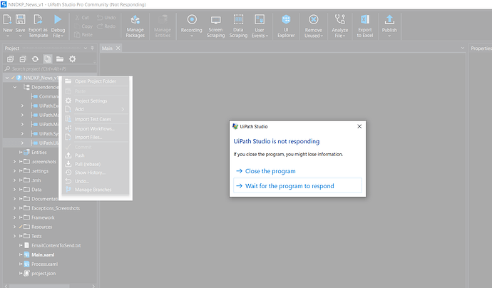

Everytime I want to make a change to my project (even a little one like adding a space to an activity name) and try to commit and push it to the remote repository my Studio instantly crashes.

No error, when i click the ‘Commit’ button with the green check on the left side, Studio instantly freezes then crashes.

That didn’t work… the problem is still here. It appears like this:
