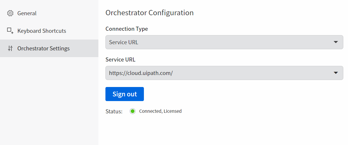

I tried all permissions and referred to a few forum messages but I am not sure why my UiPath assistant preferences not allowing me to change the details.

Hi @kkapula4,
It’s because right now you are connected with Orchestrator using SSO. If you want to connect Robot manually with Orchestrator you need to click sign out and then you will have other connection type possibility. For example using Machine Key.

Thanks for the response it worked.
