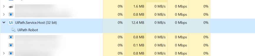

So in the image only UiPath assistant is presnet or even the service mode bot is also saved in it?
how do I check that? the bot should be saved, but will verify.
@christina.hessler
Check for servicehost service if it is available
thanks! getting the answer now.
UiPath Service Host is not running.

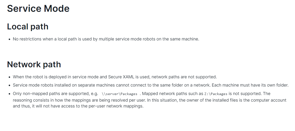

The UiPath assistant is decompressing the code into another folder (%USERPROFILE%.nuget\Packages) upon install that we believe my not be persisted.
we have told them in the past to use a shared folder that we have set up and not the user folder on the VDI. It is wiped or items cannot be saved there.
everything else works from the shared folder.
But they say they do not know how to update UiPath to put the code in that folder.

@christina.hessler
I hope this helps
https://docs.uipath.com/robot/standalone/2023.4/user-guide/custom-package-folders-and-network-paths
cheers
i will try this…
