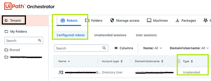

Hi, @dacostri
we have configured robot as unattended:

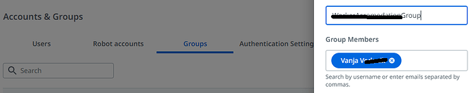

Group has no license allocated:

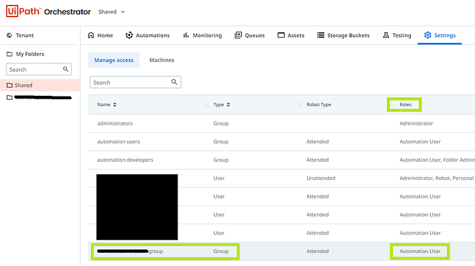

And Group has access to run APP:
And it works. :slight_smile:

Hi @dacostri
This might solve your problem:

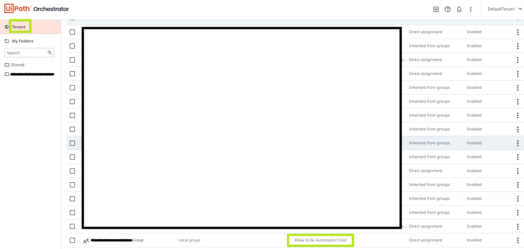

Hi @dacostri
also at the tenant level the role has to be defined:
