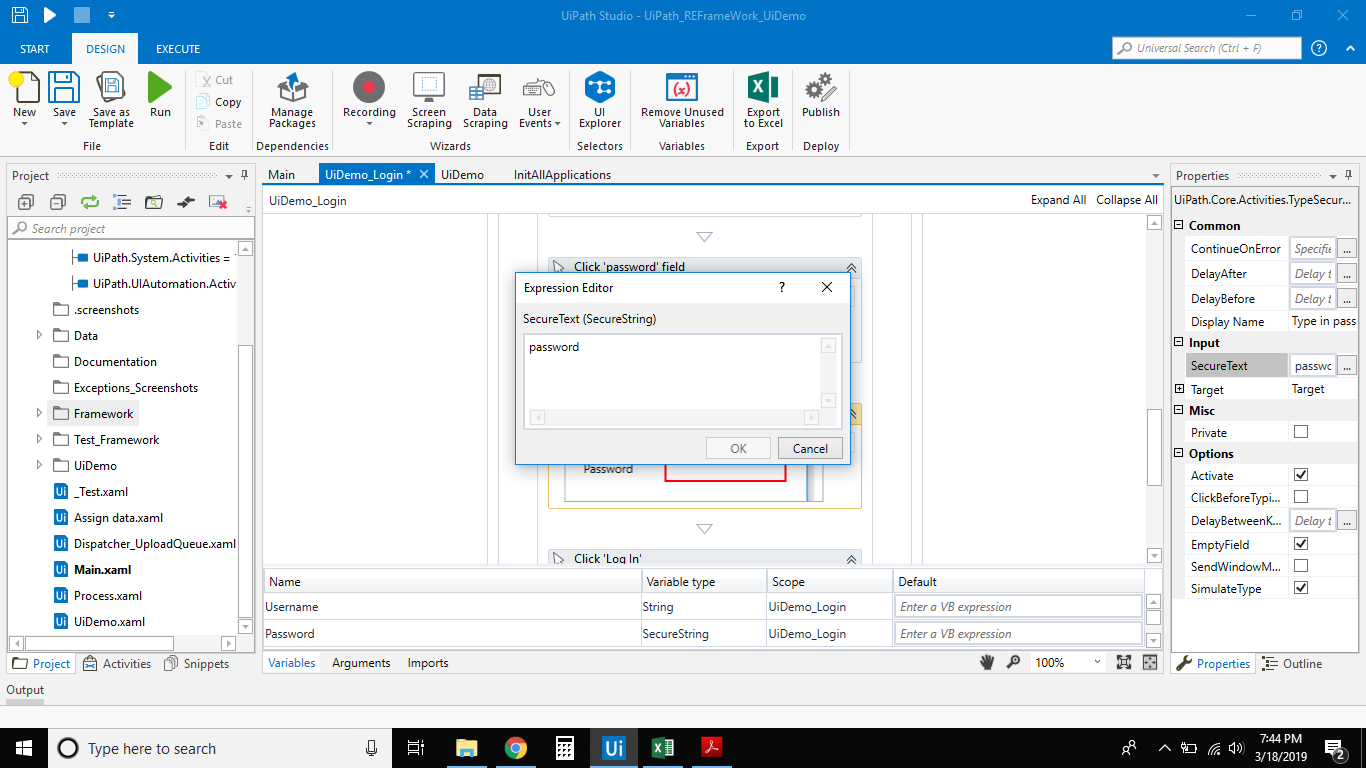

Hi Mohssine,
Have you made sure the below steps are correctly executed in your workflow:
  1. Import your arguments in the Invoke GetAppCredentials activity. They should look like this:
  2. Create the In_Credential argument in the arguments pane as per below (this has to match the value of the imported In_Credential argument in the above step) :
  3. Created the local variables (make sure these match the values in the imported arguments):
  4. List the username in the credentials asset in the config file:
  5. Your secure password needs to be listed in the properties pane in your “TypeSecureText” activity under Input > SecureText “no quotation marks”:
  6. Create the asset in orchestrator (make sure it matches the name in the config file):
  7. Check your robot is online:
This is how I got it to work for me. I hope it helps you!
As for page 6, I am stuck there too. If I hard code the UiDemo path into the workflow it works but I cannot get it to pull from the config file. Please let me know if you figure this part out!
