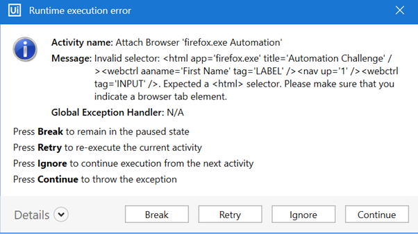

was working on the assignment 6 on selectors. However got stuck in the below error
19.7.0+Branch.master.Sha.8c253d13718eed5c7db27daef6facd1fe1b0d067
Source: Attach Browser ‘firefox.exe Automation’
Message: Invalid selector: . Expected a selector. Please make sure that you indicate a browser tab element.
Exception Type: UiPath.Core.BrowserOperationException
RemoteException wrapping UiPath.Core.BrowserOperationException: Invalid selector: . Expected a selector. Please make sure that you indicate a browser tab element. —> RemoteException wrapping System.Runtime.InteropServices.COMException: Invalid selector: . Expected a selector. Please make sure that you indicate a browser tab element.
at UiPath.UiBrowserClass.Find(String bstrSelector)
at UiPath.Core.Browser.Find(Selector selector, IVariableResolver resolver)
— End of inner exception stack trace —
at UiPath.Core.Activities.ScopeActivity.EndExecute(NativeActivityContext context, IAsyncResult result)
at UiPath.Core.Activities.AsyncNativeActivity.BookmarkResumptionCallback(NativeActivityContext context, Bookmark bookmark, Object value)
at System.Activities.Runtime.BookmarkCallbackWrapper.Invoke(NativeActivityContext context, Bookmark bookmark, Object value)
at System.Activities.Runtime.BookmarkWorkItem.Execute(ActivityExecutor executor, BookmarkManager bookmarkManager)
and my selector look likes below
Please help me to understand why i am getting the above error , i am just trying follow the walk through steps

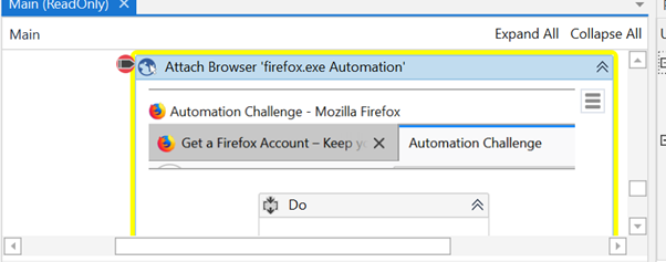

alright… So lets do this to figure out which one of those are throwing the error.
Right click on the attach browser and click on Toggle break point. This will add a red color circle next to attach browser. Now run the program in Debug mode. This will allow you to gain control of the execution once it reach the attach browser. Once it gets there, the activity will be highlighted in yellow. Now do a step by step execution.
So once it get to attach browser, and you click on next step, if it moves to the next step, that means the selector of the attach browser is fine. So like wise do a step by step to locate which activity is throwing the error. Then, based on that, we’ll get together and fix the problem selector :slight_smile:
Let me know how it goes…
Hi Fernando,
Followed steps as suggested by you above, please find below screen shot

Hi Fernando,
Shared debugging details of the above issue, could you please help me on this?
