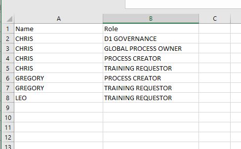

Book2 - where I have column with name and Role
Capturebook2
My point is to compare those DT’s and if I have in Book2 the same name as I have in Book1, I want to take the Role and write into the next free column in corresponding row in Book1

I need to have finally DT as below
