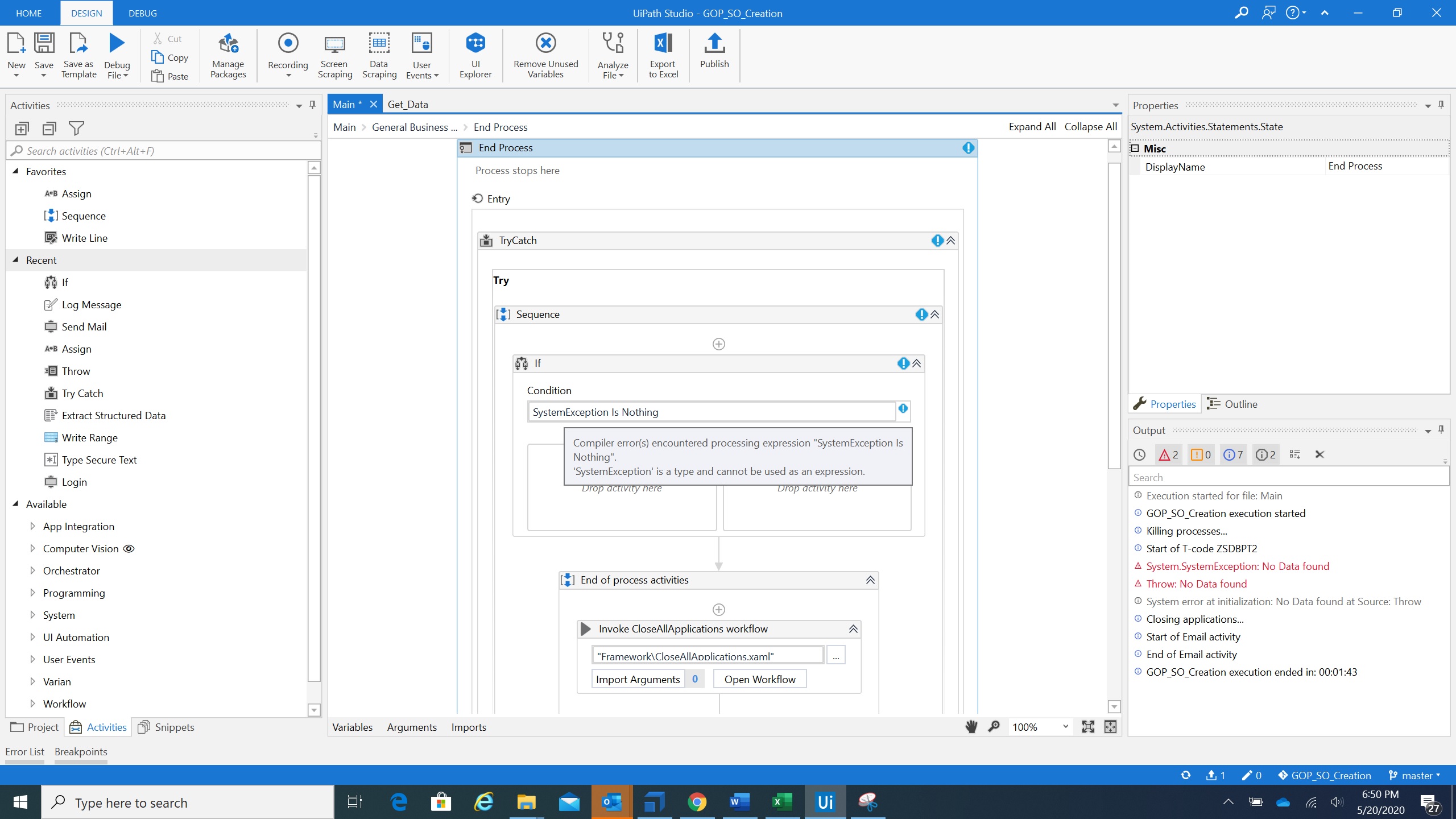

Hello Anthony,
Below is the error screenshot.
Can you also share the variable from the Variables panel? Curious to see the datatype or if anything about it has changed. View the variable while in End Process (want to also make sure that it is in scope).
Hello Anthony,
Please find attached variables screenshot.
Ah, I see. I think the variable has been changed in REFramework. Use SystemError Is Nothing instead.
