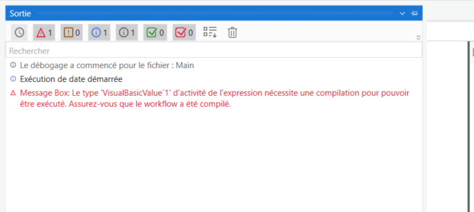

I have this problem ,thank u
Could you please attach the activity/actions that you are using in the main file…?
here the activity , Best regards
here the rest part best regds

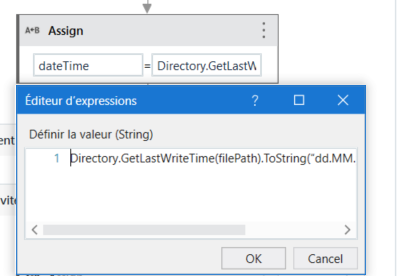

Try
Directory.GetLastWriteTime(filePath).ToString()
and
Directory.GetLastWriteTime(filePath).ToString("dd.MM.yyyy-HH.mm.ss")
hello, now i get the date of the creation of the file
then for the trigger my I add a condition for this in order to see if the new file is arrived then the trigger must start
