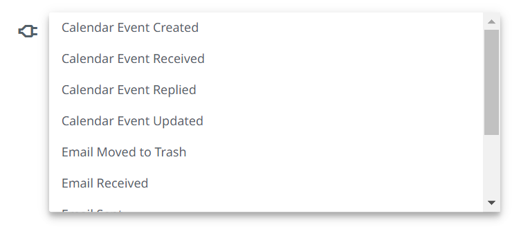

is this correct bro
You need to change the event from Calendar Event Received to New Email Received
I don’t have that option
Use Email Received here
okay Email Received than
Add the Trigger, and thats it!
Now once you receive an email the bot will get triggered with respective process you have selected!
