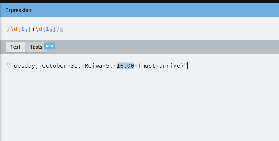

Hi @kiki1
You can use the below regular expression,
- Assign -> Input = "Tuesday, October 31, Reiwa 5, 16:00 (must arrive)"
- Assign -> output = System.Text.RegularExpressions.Regex.Match(Input,"(\d+:\d+)")
Hope it helps!!
Hope it helps!!
