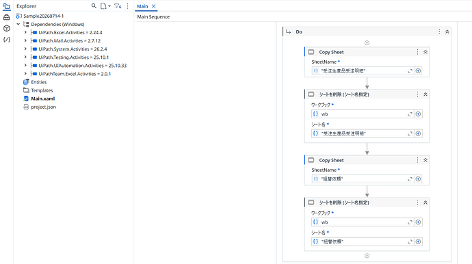

I arranged it as follows, but I can’t reproduce it in my environment.

I am also assembling it in the same way.
