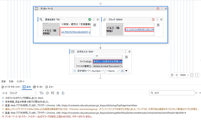

I am currently automating a page that has multiple objects with the exact same selector except for “aaname”. Since “aaname” is variable, I am trying to set the click activity while disabling that part, but it’s not going well, and even when I set it based on an anchor, I encounter errors.
(The modern activities did not work because the page switches.)
Furthermore, I cannot know the value of “aaname” in advance, so I cannot store it in a variable.
If anyone knows how to configure the click activity in this kind of situation, could you please share your guidance?

I checked UIExplorer, but everything is the same except for “aaname.”
“aaname” is jpg, PDF, png, but do you know if it is possible to set something like an OR condition?
