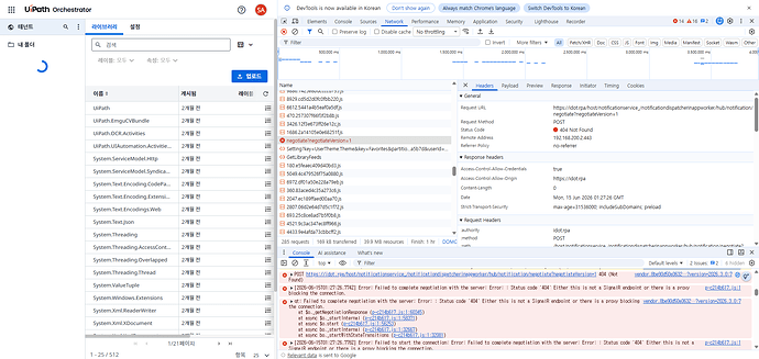

After connecting to the host tenant and going into the Orchestrator menu,
  1. I encountered an error where the notification service page could not be found.
  2. I experienced an error where the folder could not be found.
    HttpErrorResponse: Http failure response for https://idot.rpa/host/orchestrator_/api/FoldersNavigation/GetFolderContext?includePersonalWorkspace=true&relativeSkip=-25&take=50&folderId=0: 404 OK
Do you have any idea what the cause might be and what the solution could be?
Thank you.

Most things are normal, but it appears that folders were not automatically created in the host tenant’s orchestrator when installing UiPath Automation Suite.
