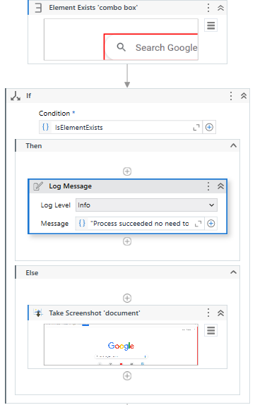

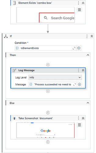

You can use “Element Exist” Activity to check whether you are getting the Proper output if not you can put an if condition and put if element is not exist then u can add take screenshot activity Like below
