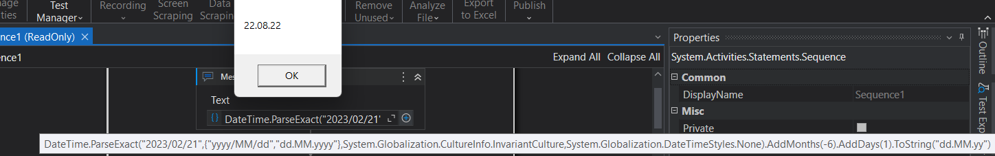

HI @spaceforce
Check this
Variable 2 =
DateTime.ParseExact(Variable1,{"yyyy/MM/dd","dd.MM.yyyy"},System.Globalization.CultureInfo.InvariantCulture,System.Globalization.DateTimeStyles.None).AddMonths(-6).AddDays(1).ToString("dd.MM.yy")
When you print the variable 2 you can get your answer
Regards
Sudharsan

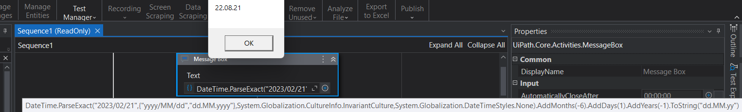

@spaceforce
If you want the year also to be modified as previous year use the below one
DateTime.ParseExact(Variable1,{"yyyy/MM/dd","dd.MM.yyyy"},System.Globalization.CultureInfo.InvariantCulture,System.Globalization.DateTimeStyles.None).AddMonths(-6).AddDays(1).AddYears(-1).ToString("dd.MM.yy")
Regards
Sudharsan
@Sudharsan_Ka
Thank you.
I was able
Thank you very much.
Yoichi
