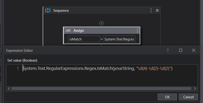

Hi @momoninimo
You can use regex activity to achieve that
This patter checks if there is a dddd-dd-dd pattern in your string (d is a digit).
Right side of Assign activity:
System.Text.RegularExpressions.Regex.IsMatch(yourString, "\d{4}-\d{2}-\d{2}")
yourString
is string you want to input. For example “2022-02-03”.
Left side of Assign activity:
isMatch
is a boolean type variable, it becomes True if string matches.

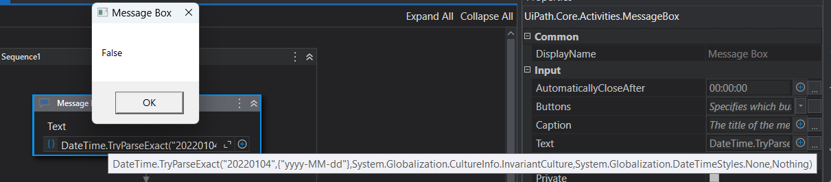

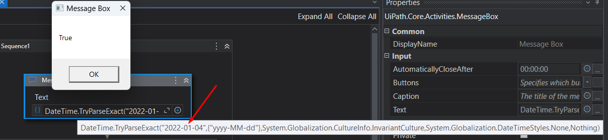

HI @momoninimo
Try this expression
DateTime.TryParseExact("YourDateVariableString",{"yyyy-MM-dd"},System.Globalization.CultureInfo.InvariantCulture,System.Globalization.DateTimeStyles.None,Nothing)
You can give this directly in the if
Regards
