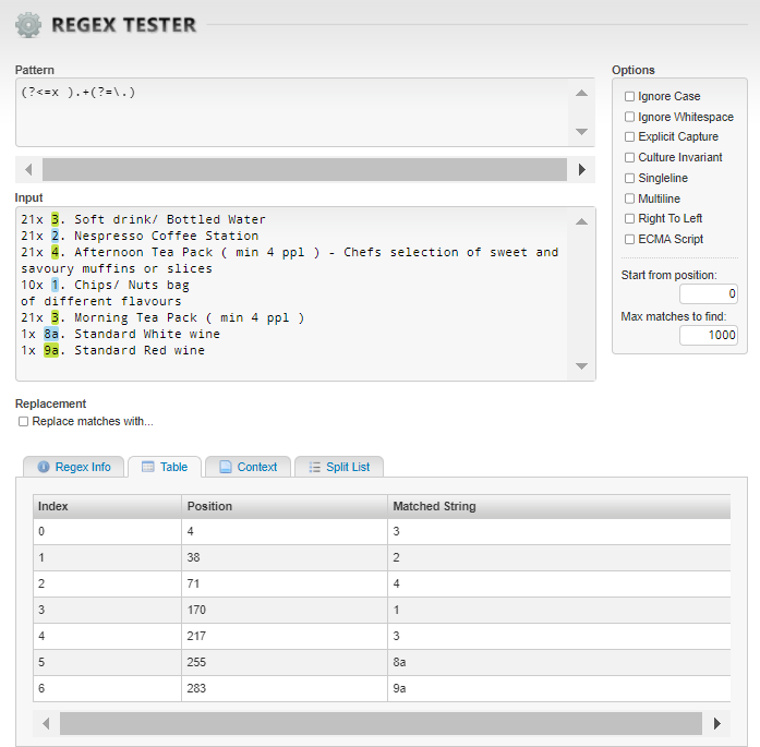

@ciaramkm - You can try the below regex pattern…
(?<=x ).+(?=\.)
Or
(?<=x )\S+(?=\.) - If you any other period in the sentence..

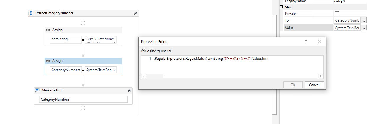

Hi. Thank you for the suggestion, I attempted it with the below workflow but it kept returning a blank output

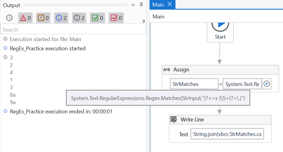

@ciaramkm - since you are looking to return multiple items, you have to use Matches…Not Match…
give me a min…i will show you…
Update: Please check this…
Here StrMatches is of variable type: Match Collection(system.text.regularexpressions.MatchCollection)
Write Line(Without Looping) = String.join(vbcr,StrMatches.cast( of Match).Select(function(x) x.ToString))
